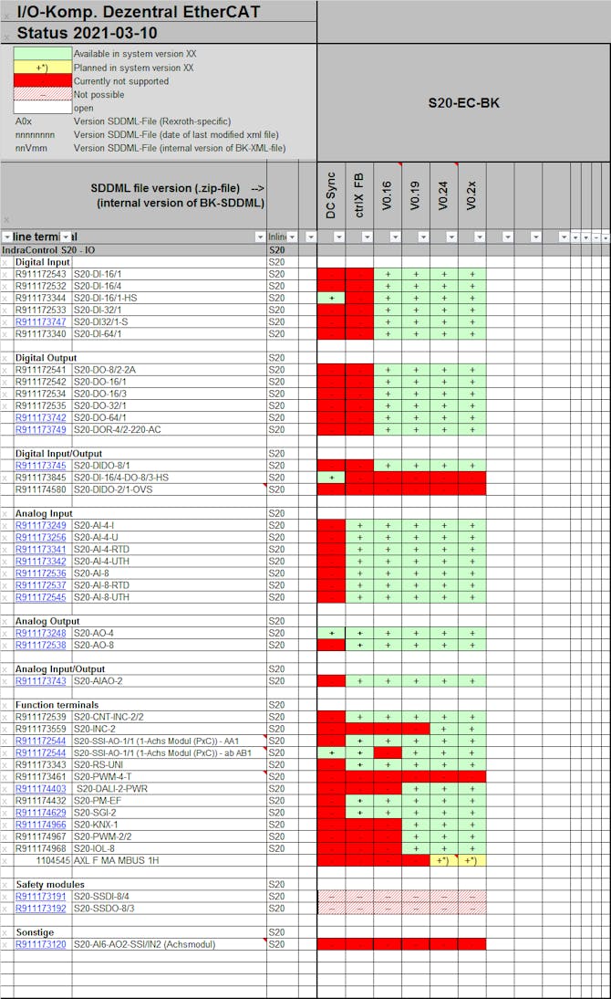

Which S20 IO modules are supported on the S20 EtherCAT bus coupler?
ย ย
Best reply by ChristianZ
The following list shows the module, which are supported.
