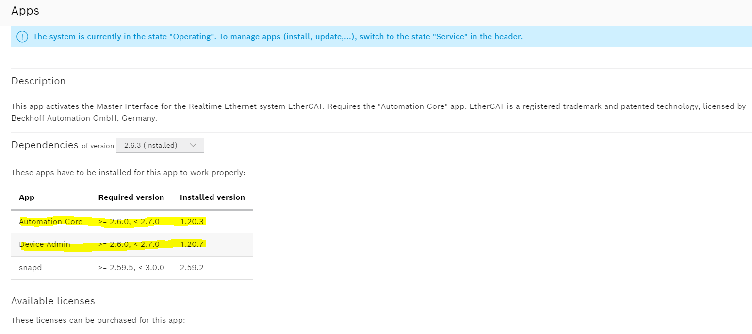

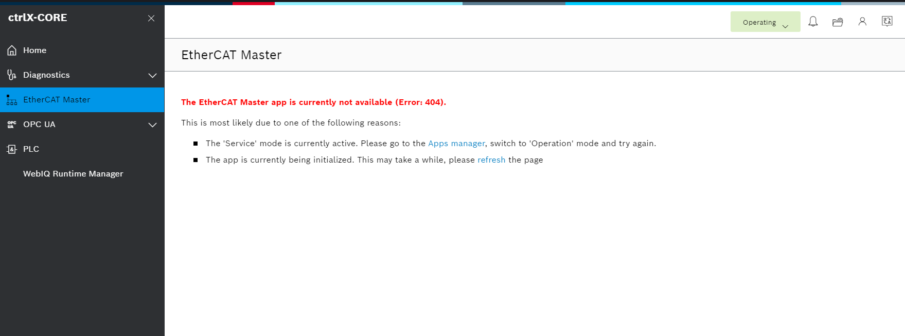

Im using an X3 controller, have the IDE installed on my engineering PC and all the licences were purchased and installed by our rep. Im running into an issue with trying to configure my Ethercat Master app. When I open it up I get 404 message. I did some searching and found that maybe my dependcies for the app arent up to date? Im not sure so I have included a screen shot of what Im looking at.

You are correct that this is a dependency mismatch. You can see in your second image that you have system apps v1.20 and have installed v2.6.3 of the EtherCAT master application. You have two options...
  1. Upgrade your system applications to v2.6 to be compatible with the currently installed EtherCAT Master
  2. Downgrade your EtherCAT Master to v1.20 to be compatible the the currently installed system applications
In either case, the applications can be found in the collaboration rooms.
