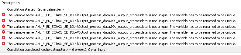

When compiling the attached project I get "The variable has to be renamed to be unique" errors originating from the AXL_SE_IOL4 module.
This occurs in IO Engineering 2.6 and 3.6. Removing some modules can cause the error to disappear or to indicate a different module instead, the behavior seems inconsistent.
Is the Phoenix coupler/module incompatible?
