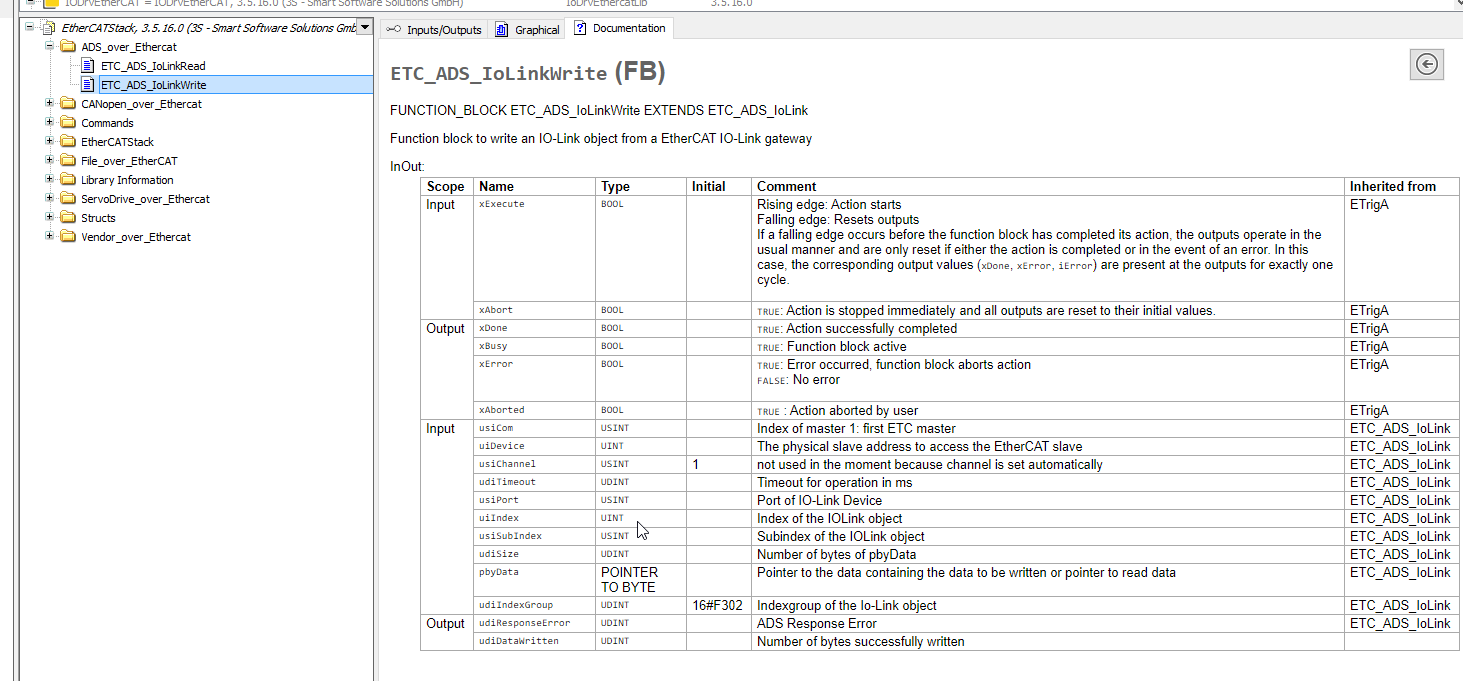

We have a project in Codesys where we use ETC_ADS_IoLinkRead and ETC_ADS_IoLinkWrite FB from library EtherCATStack to read and write IO-Link parameters over EtherCAT to the IO-Link matser. Our idea is to try to move our project to ctrlX Core. We want to write IO-Link parameters over EtherCAT to the sensors at start up. Is there any FB for reading and writing IO-Link objects from an EtherCAT IO-Link gateway for ctrlX Core?
