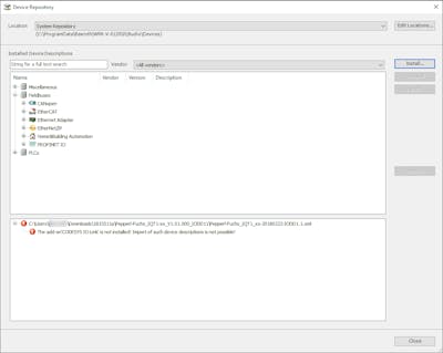

By default configuration you recieve the following error when trying to install IODD file into ctrlX IO Engineeering device description.

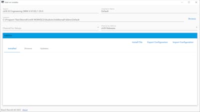

We can confirm the error message by visiting the add-on installer

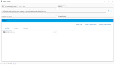

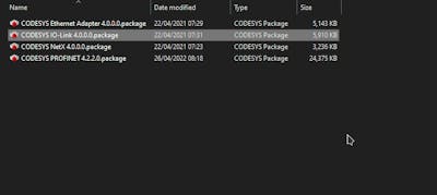

Within the CodeSys - Addon  Profinet Controller you can find the IO-Link package (as you will see below, this works for Ethercat, not use profinet)
Here we have installed the package

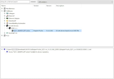

And here we can see the IODD file will now install and can be used in configurating the IO
