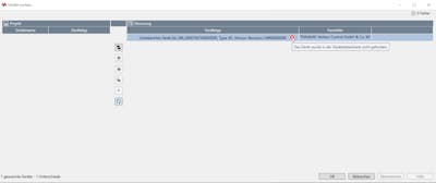

how can I configure a EtherCAT slave that is not found in the devices repository of ctrlX I/O Engineering?
The device in question is a stepper motor control unit by Trinamic.

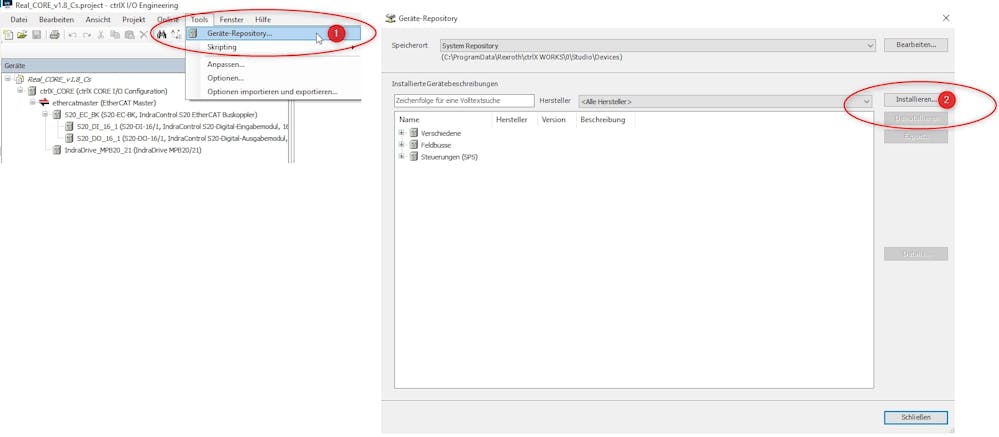

Please install the device description file (*.xml) from the 3rd-party supplier:
