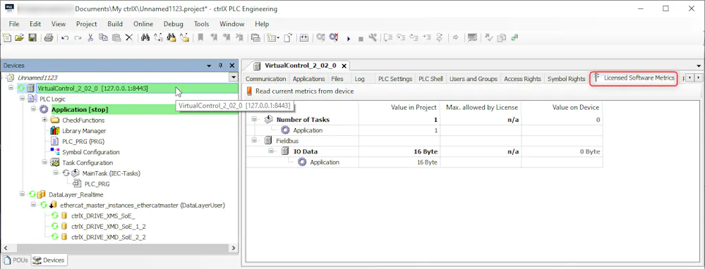

You can check all licensed software metrics like utilized IO data via the corresponding tab in the device data in the ctrlX PLC Engineering online and offline:
