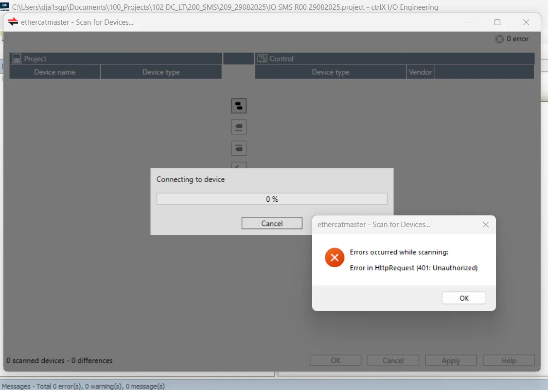

I am using IO Engineering 3.6.2. While i do "Scan Device", i always error "Error in HttpRequest (401:Unauthorized).
I am looking for any advise.

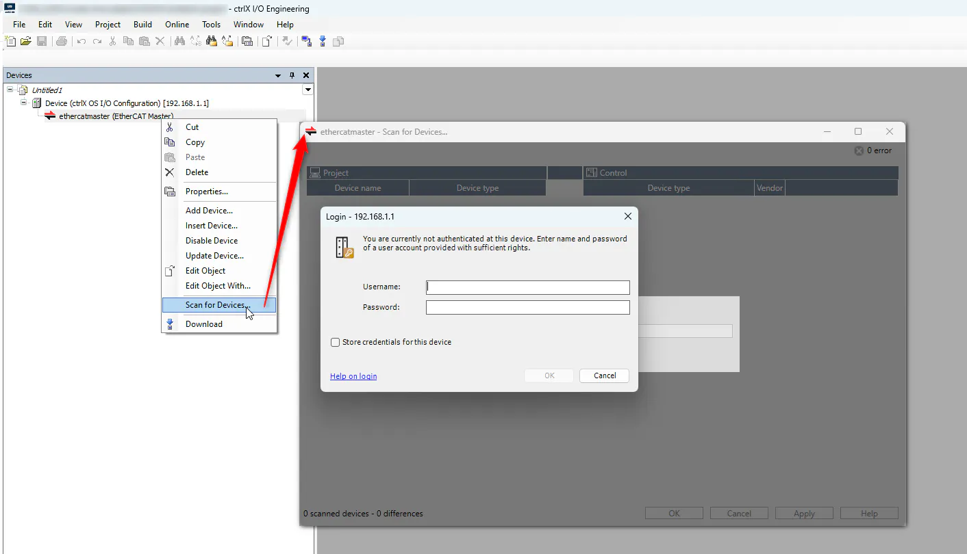

Did you enter incorrect credentials in the IO Engineering? To be able to access data on the ctrlX OS you need a user with the corresponding access rights.
ctrlX IO Engineering - enter credentials when scanning
There is also online documentation available that can be reached when clicking the link in the login screen.
