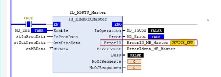

Hi Community,
I am using the ctrlX IO XI522001 Modbus RS485, the device is having error in the RTU_Master function block. Is there an ErrorID description to refer to?

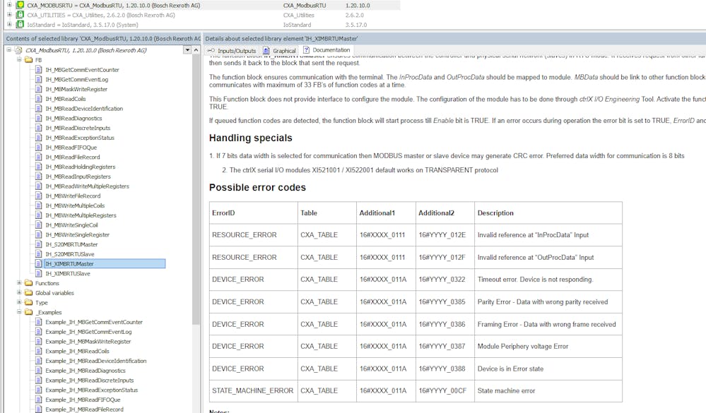

Hi OpenÂ
check the library, there are possible error codes directly in the function block description.
You can also find examples for structured text.
