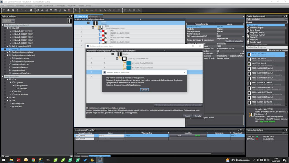

Today i tried to run the ctrlX i/o s with a potential customer which has Omron as master ethercat but we were not able to run them. He expected to write the address and then reboot the IOs but it fails during the address writing process. the error states in italian: "impossible to set the slaves addresses"
Is there already someone who tried them with Omron or encountered a similar issue?

Omron control currently not supported, because the Station Alias Register 0x0012 is 0.
The ctrlX IO are developed to support ctlrX CORE in the first step. The implicit addressing with the ctrlX CORE works fine.
We are checking for improvements with future releases.
