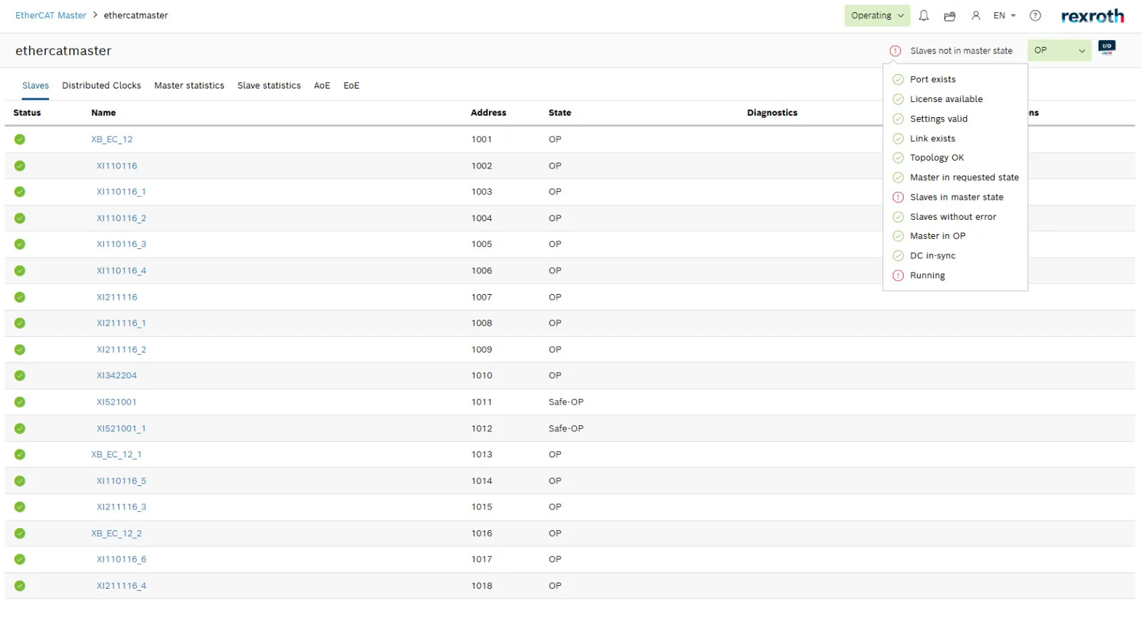

I´ve got a ctrlX 1.2 Configuration where I had 2x XI521001 modules to communicate by ASCII with some devices.
I´ve already separate them in a different Sync Unit from other devices, because they are oscillating connection - time from time they go to "Disconnect" and after a while go to "Safe-OP". At least they doesn´t bring the entire network down.
I tried to find a new firmware that could help me with that issue but there is no newer release opened at Rexroth Site.
Is there any problem or known issue with this module? Ideas of what could let this modules down?
