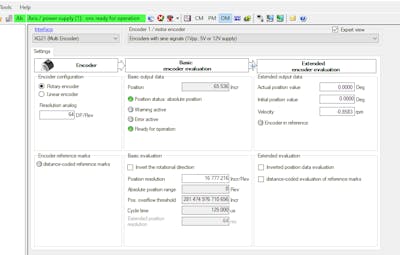

I connect the sincos encoder to the XG21 multi encoder connector.
I use encoder ITD 49H00 0064 M  of baumer and mechanic connected to the motor shaft.
this is an Sincos encoder 1Vpp with 64 period per revolution.
so i configur this as encoder 1 see picture below:
When i move the motor shaft i see the value basic output data changing but i do not see the value actual position value at extended output data changing.

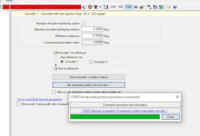

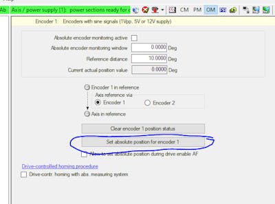

Also i can home the encoder by SET absolute position.
then i get the message:
What could be the problem?
