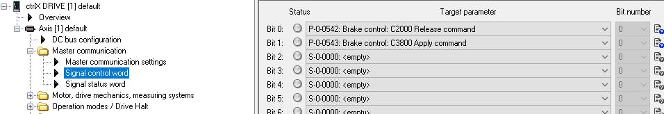

Hello Thomas,
Adding P-0-0543 or P-0-0542 to the MDT is not allowed. Instead, I would suggest mapping the commands to the Signal Control Word (show below in ctrlX Drive Engineering) or utilizing acyclic communication services to run the commands (Ex. the IL_ECATSoeCommand function block in the ctrlX PLC app).
