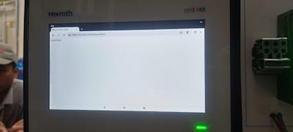

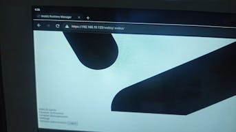

Helo, i have facing issue with CtrlX HMI WR2107 and WebIQ HMI. I create a WebIQ HMI and upload it to WebIQ Runtime in CtrlX, when i try to access the HMI using tablet, smartphone, and laptop everthing is fine. But when i try to access the HMI using CtrlX HMI WR2107 it's appear like this
Using HMI default browser
Using Chrome Browser

I currently only encountered the behaviour on the first picture when addblocker were used in the HMIs or other browser settings were blocking the loading process.
