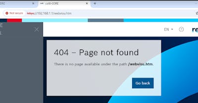

Iโ€™m new to PLC programming and am currently trying to design an HMI using Ctrlx Codesys and Webvisu. I have obtained the Webvisu license, but I cannot find any documentation on how to display the HMI or set up the WR21 with the Ethernet port for display. Can someone assist me with this as I am a complete beginner?
Additionally, I encounter an error when I run Webvisu on my local machine. Any help would be greatly appreciated.

But the WR21 must have an different IP-adress then the ctrlX CORE !ย  ย  ย Does the CORE has different then 192.168.1.1ย  ย ?
