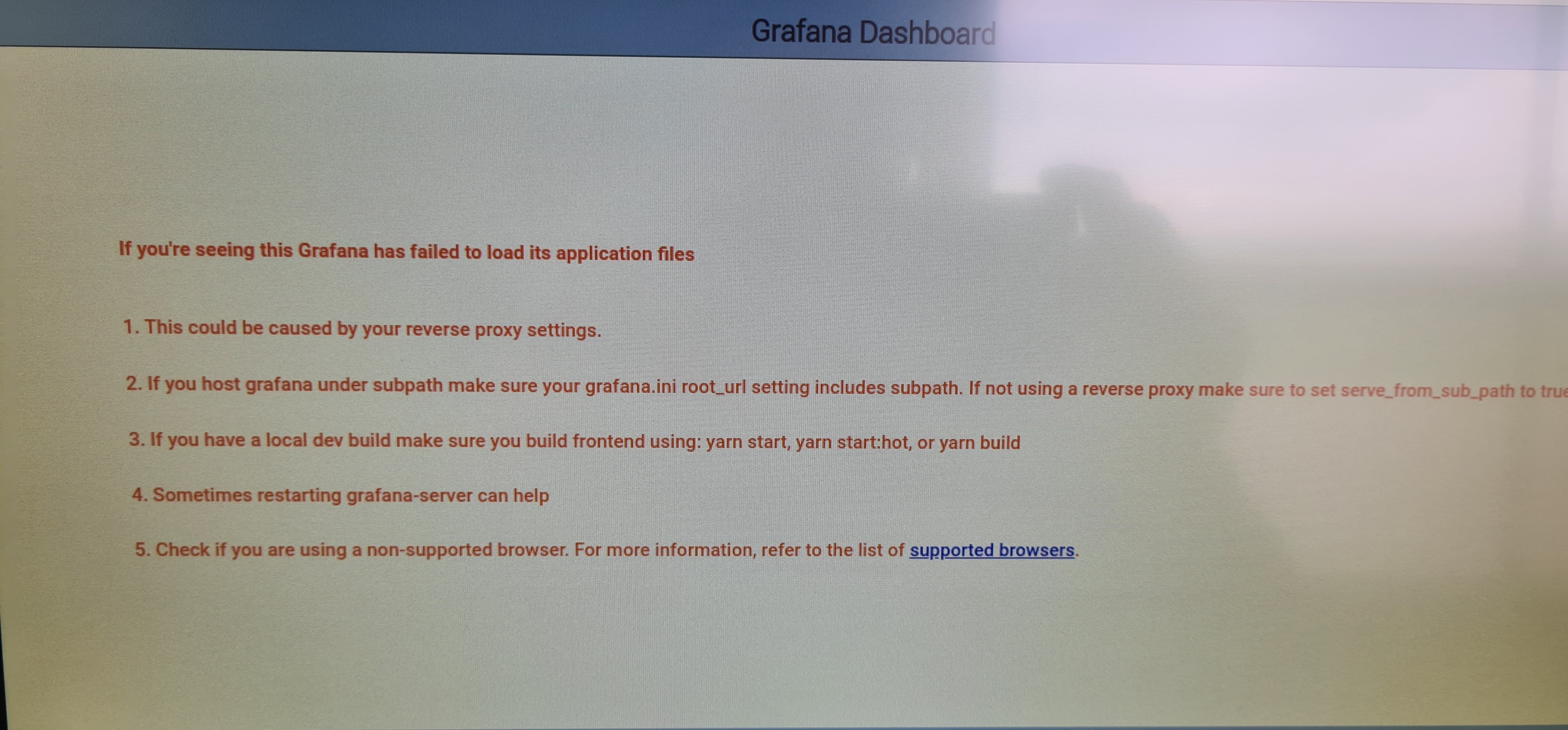

When the WebIQ visu is opened inside my Laptop's browser (FireFox V112.0.1 (64-bit)), the grafana frame is displayed correctly.
But when the page is loaded on the WR panel using webstation or chromium, i get the error shown in the attached Picture.

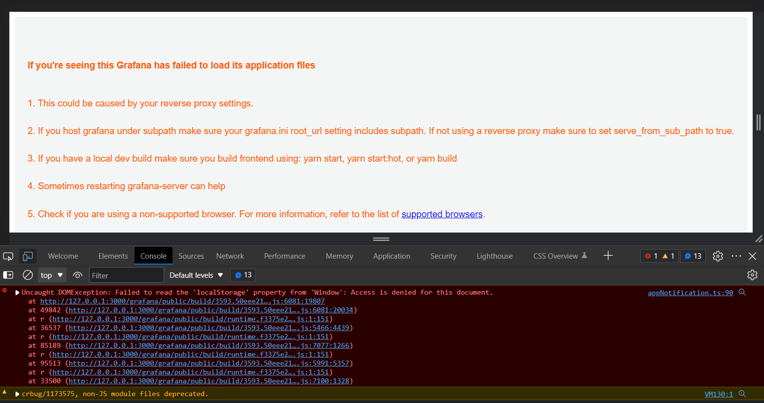

I was able to reproduce the same behaviour on a browser that does not allow third-party cookies. I get the same error displayed in the attached picture, but i am not sure if that is the exact same reason on the WR panel.
it seems that grafana failed to access the 'localStorage' property from 'window' due to a denied access to third-party cookies.
To check if that is reason also on the WR Panel, is it possible to change the settings of webstation or chromium to allow third-party cookies?
