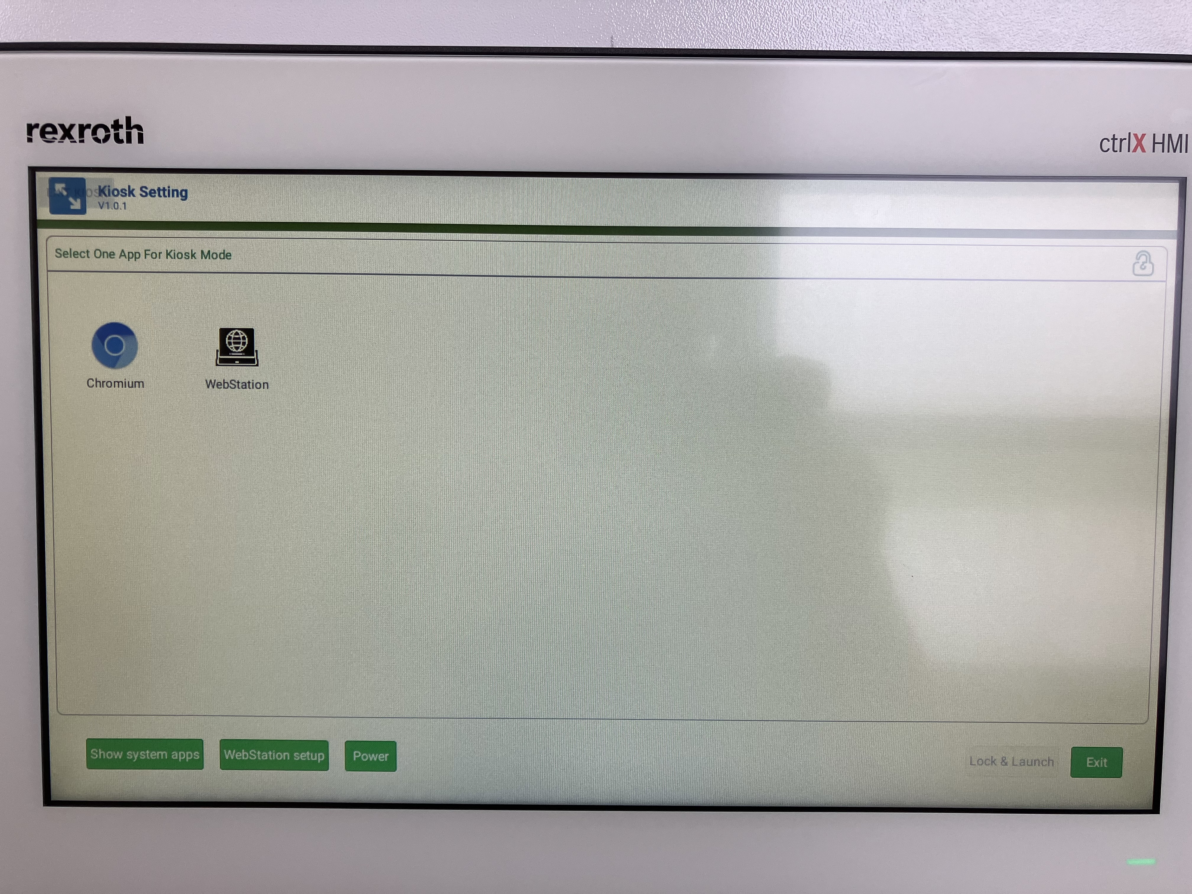

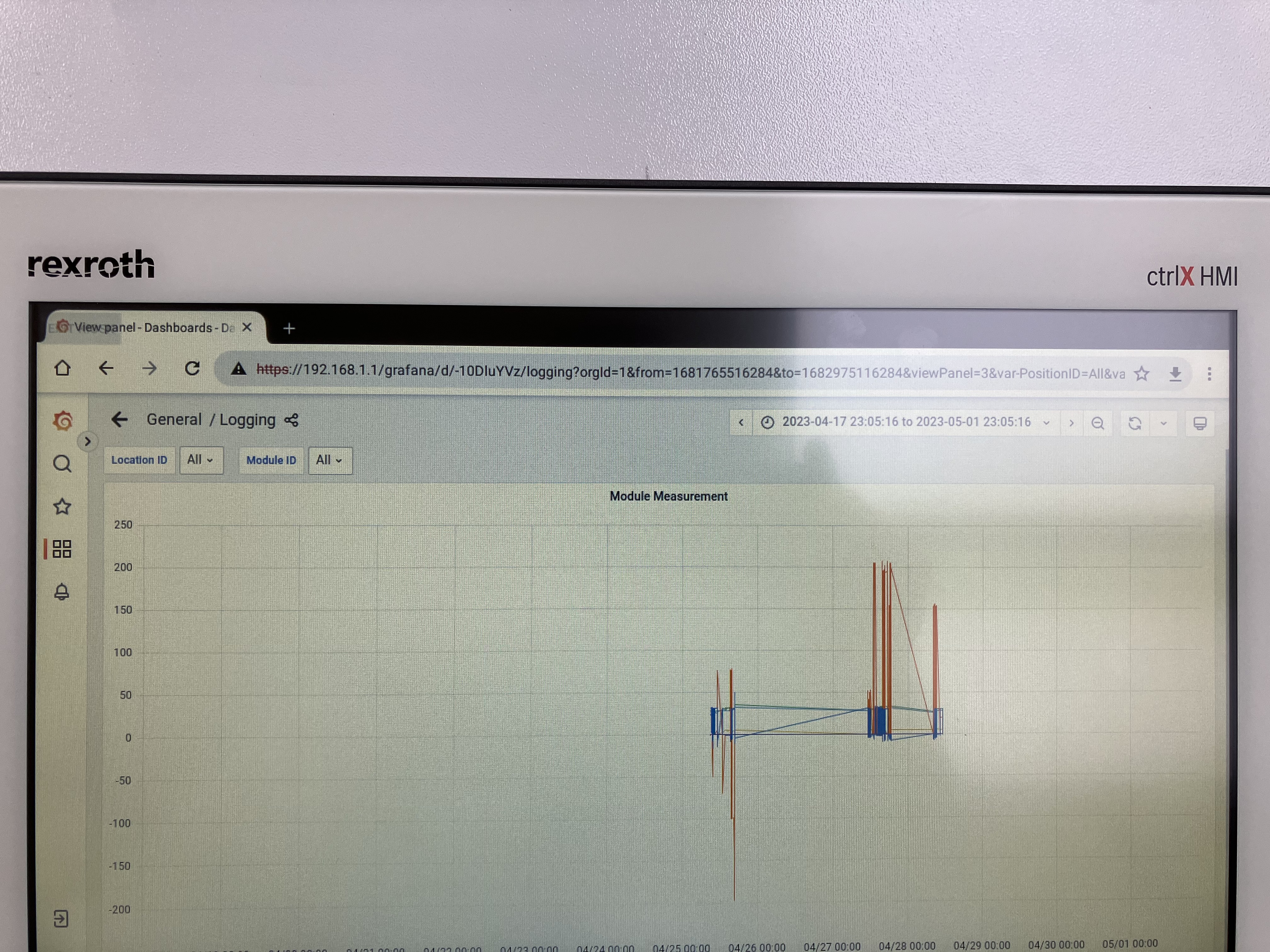

As it is not possible to display grafana dashboards (which is now an official Bosch Rexroth App) on the default browser (webstation), i tried chromium and it works!!
But i did not manage to start and lock chromium in kiosk mode using the default kiosk Launcher.
Is it possible to achieve this with chromium or do i need to install another browser or another Launcher?
If an another App is needed, how do i manage to install it on the WR21 panel?
Your Support is appreciated.

for the community:
we were able to solve the issue with the person who asked the question by updating the image of their webpanel. With our new image release (currently RC4) we also updated the version of the browser which was the issue here in that question.
