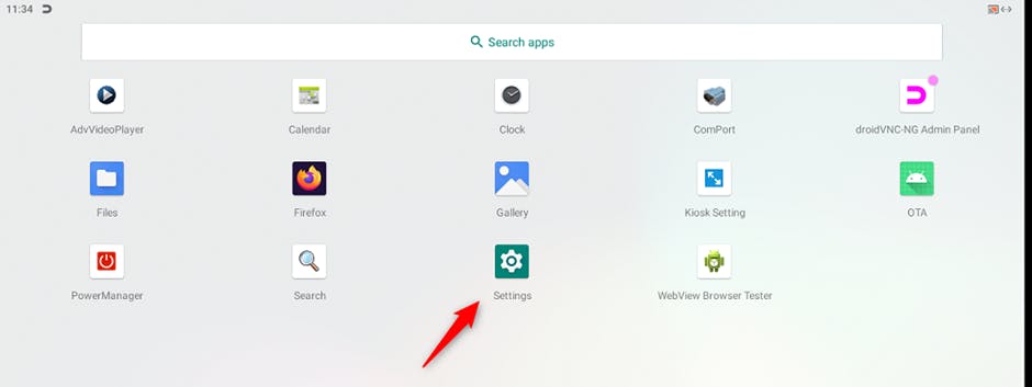

  • Swipe from bottom of screen to top, until apps screen is visible
  • Tap icon „Settings

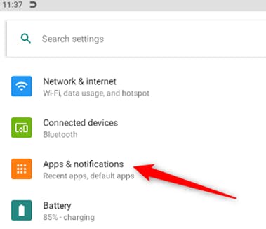

  • Tap „Apps & notifications“
  • Tap icon „Apps & notification”

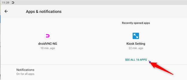

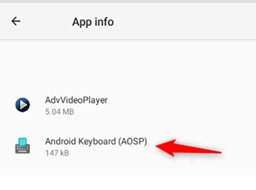

  • Tap text “See all 16 APPS”, then tap “Android Keyboard (AOSP)

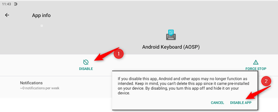

  • Tap “Disable” (1) and confirm dialog box with button “DISABLE APP” (2)
    That's it. You have disabled the virtual keypad
