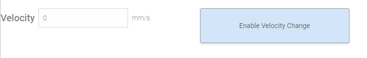

I'd like to write in an input field a new value for a PLC variable, but I'd like it to not update the PLC variable until I press a button.
So used an input field widget linked to a internal variable and a button which should write the value of the internal variable to the PLC one. But it seems not to work.
Could you please help me?

Solution:
1. Create a virtual (!) item and connect it to the input field - do not use an internal item as potentially different users might want to set different values here
2. Write a custom UI Action that uses readValue() to read the virtual item value and then writeDirect to write the value read to the PLC item
