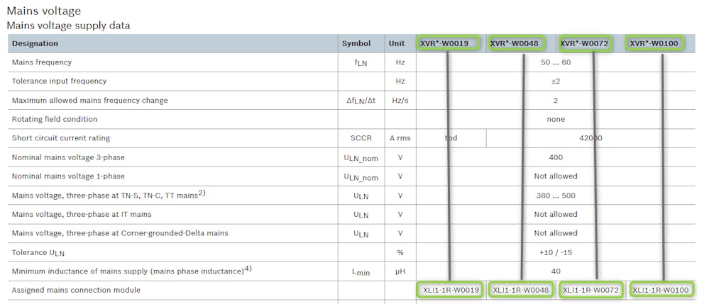

Do you know if we hace a cross referece between our XVR and our XNL1 or if are there a manual released for XNL1

For XVR devices only XLI devices can be used, see:
ctrlX Configurator already takes into account the power of the connected axes to the power supply unit.
