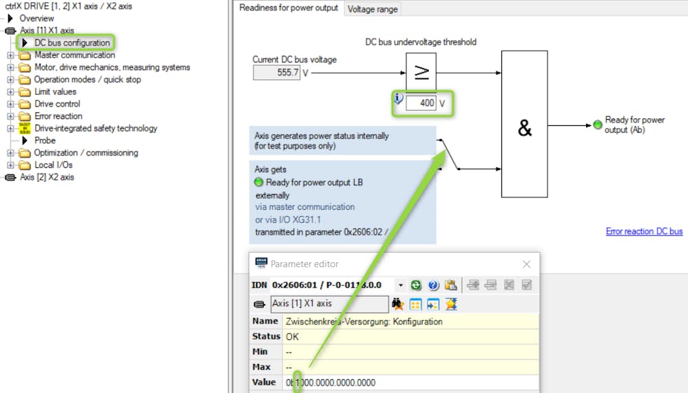

For XMS and/or XMD just set the following parameters:

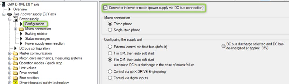

For XCS and/or XCD set the following parameters additionally to the ones for XMS/XMD:
