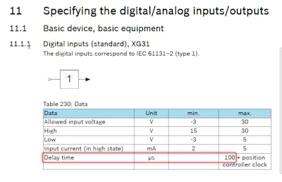

I see in the documentation that the delay of our digital inputs is 100us:
1) Should we consider this delay time? So the test pulse should be less the 100 us?

To question 1: No, this needs not to be considered.
