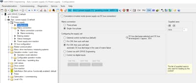

We've just got few ctrlX DRIVE demo kits from Germany (pn: R911418966) and I am wondering here if there is way to move the axis from bb to Ab with 120Vac as the mains single phase.
The drive has AXS-V-0404 firmware and I am trying to have the Ab as soon as it jumps to OM (with DC Bus charged).

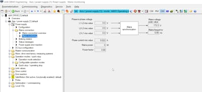

I can see that the mains peak voltage feedback is there, but the mains frequency (S-0-2016) remains at 0Hz. I have also tried using the IOs at the XG31, but no success.
Should I force some "reserved" bit somewhere? Are other parameters (like P-0-0860) that I should force just to test here in Lab? No high speeds and no load.

Best reply by Drives_Uwe
Unfortunately this is not possible. Use a power supply device in order to create a 24 or 48 V DC voltage. Then you can make the ctrlX DRIVE amplifiers work in inverter mode. Set DC bus voltage threshold to 20 or respectively 40 V. Set P-0-0118 Bit 15 to โ€ž1โ€œ!
