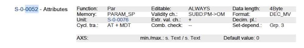

In my particular case it is the paramter "S-0-0052, Reference distance of encoder 1". This parameter can be positive and negative.
Its format is DEC_MV(Signed decimal number). But in the C++ interface the data to send is a vector of uint8_t so a vector of unsigned numbers. Is there a logical conversion to a negative number? I have tried to set the first bit to 1, representing the minus bit for a signed, but this does not work.

Also the decimal place in the documentation is emtpy, which implies for me it is 0. After testing I found out it is actually 4.

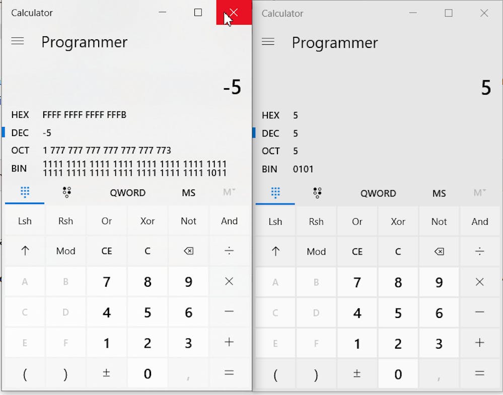

Changing only the first bit could be not enough depending on the data size. Here an example simply made with the calculator:
