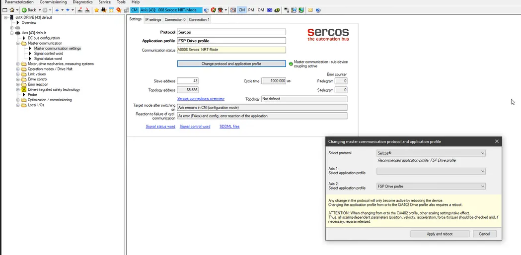

With double axis, one axis unreachable (grey) and show PMD1-W2323

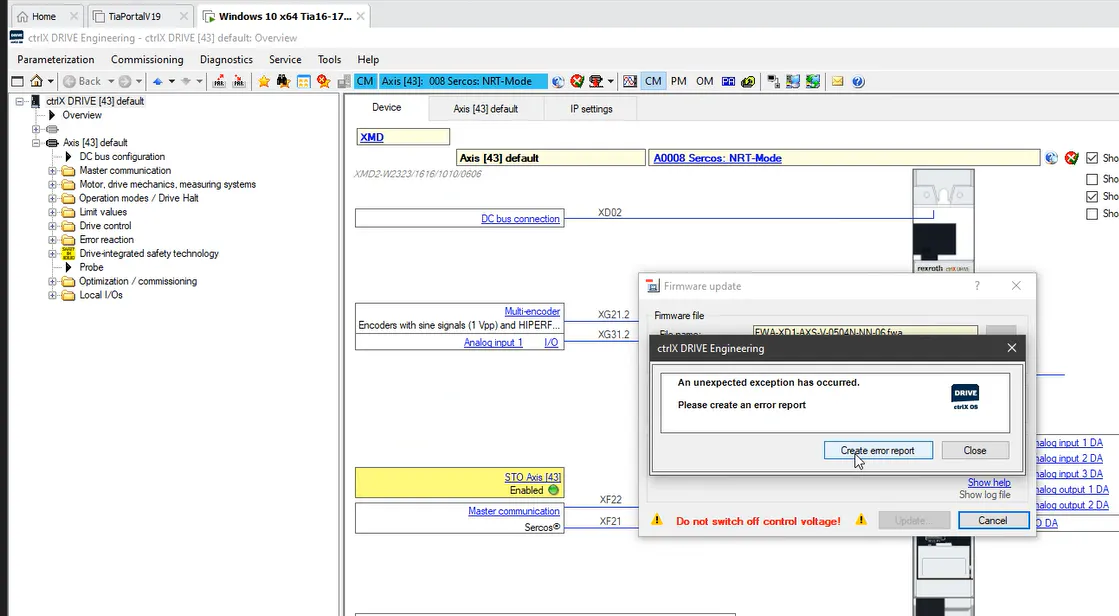

In a Sercos setup with multiple drives I have the following problem. I cannot reach the first drive, not over USB nor Ethernet. I updated the drive to the most recent 05 Firmware (Patch 6) but the problem stays.

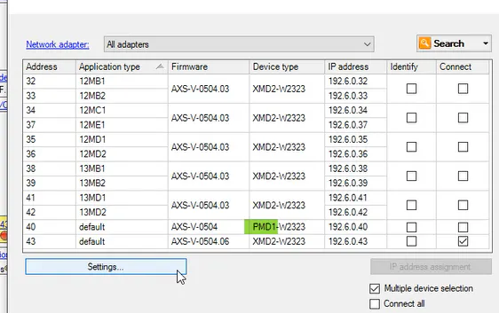

I also cannot change the Application profile. The most remarkable thing I see that the drive shows PMD1-W2323 while it is a XMD1-W2323.
