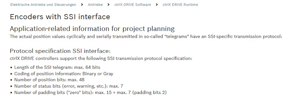

one of our customer is aksing whether our drive can evaluate the digital encoder with the resolution 36 bits.
according to our MPx21 application manual, 6.6 measuring system, the Max. resolution is 30 bit and we can not do this application.
but in ctrlX runtime manual, the max. vlaue is 48 bit now, is this means we can evaluate the 36 bit encoder now?

With SSI encoders now up to 48 position bits are possible, see:

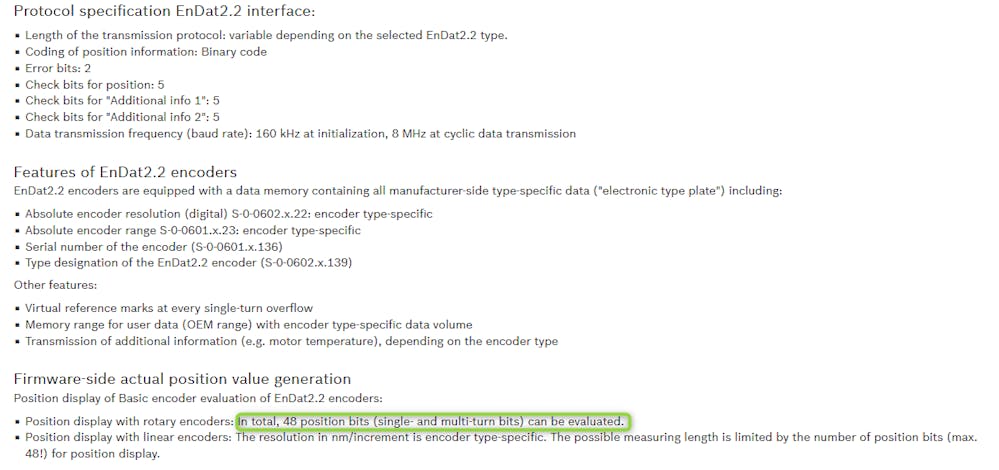

Similarly with EnDat 2.2 encoders, see:
