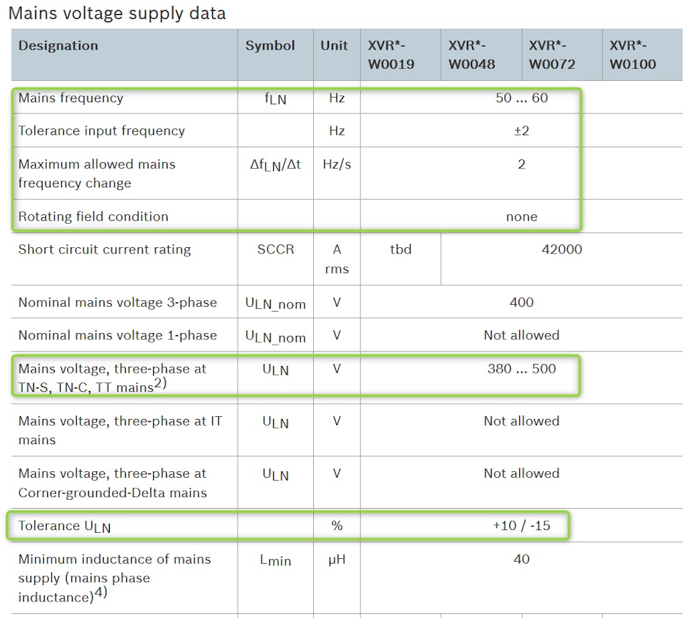

An uninterruptible power supply (UPS) can be used with XVR as long as the mains pre-requistes for the XVR are maintained.
Alternatively a kinetic buffer (see e.g. LINK ) or additional capacitances may be used for short time (up to several seconds) bridging the loss of mains.
