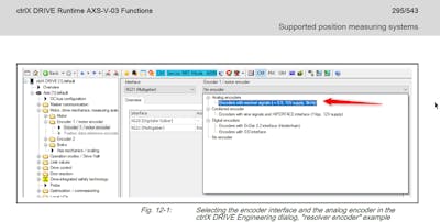

Based on the information that I got from the CtrlX-Drive VRS-03 Functions Manual edition 3 (R911410073), the firmware does not support square-wave signals (TTL) as analog encoders.
According to the screenshot below, only Resolvers are supported as analog encoders.
Are there any plans to support TTL encoders in the near future?

Best reply by Drives_Uwe
At the very moment the planning is to support no TTL encoders. Please address to your sales contact if you need such an encoder.
