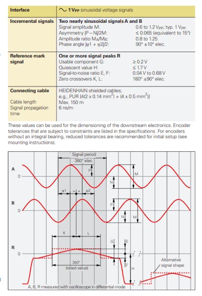

sin-cos encoder 1 Vpp with reference track - heidenhain
Hello:
The client wants to install a Heidenhain encoder - ST3088
What supply voltage should be 12vdc or 5vdc
and what connection does it have in the controlX drive- encoder EC?
thank you
