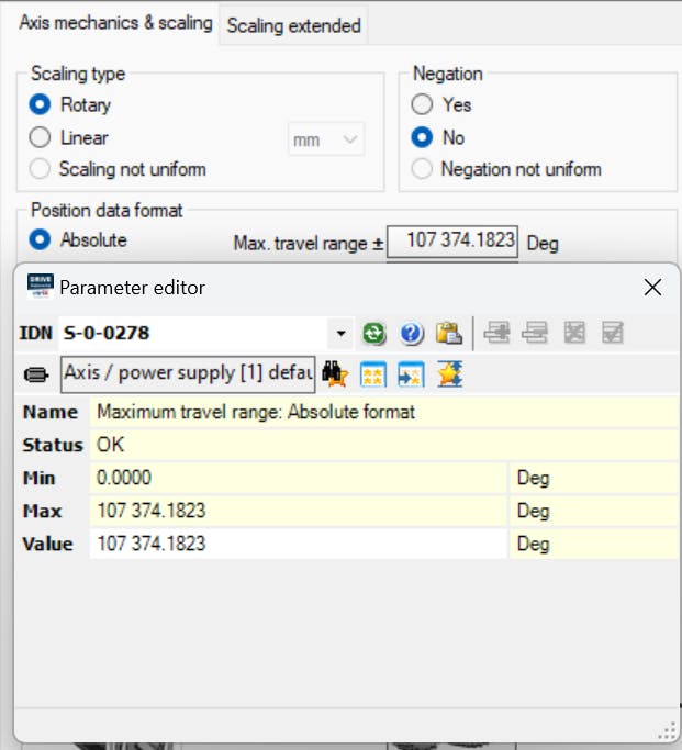

Ctrlxdrive S278=107374.1823

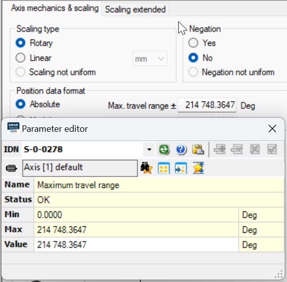

HCS01 S278=214748.3647
The same motor why there is a difference.
Handling of parameter S-0-0278 (maximum travel range) has been changed from IndraDrive to ctrlX DRIVE.
Should be of no consequences to the OEM.
