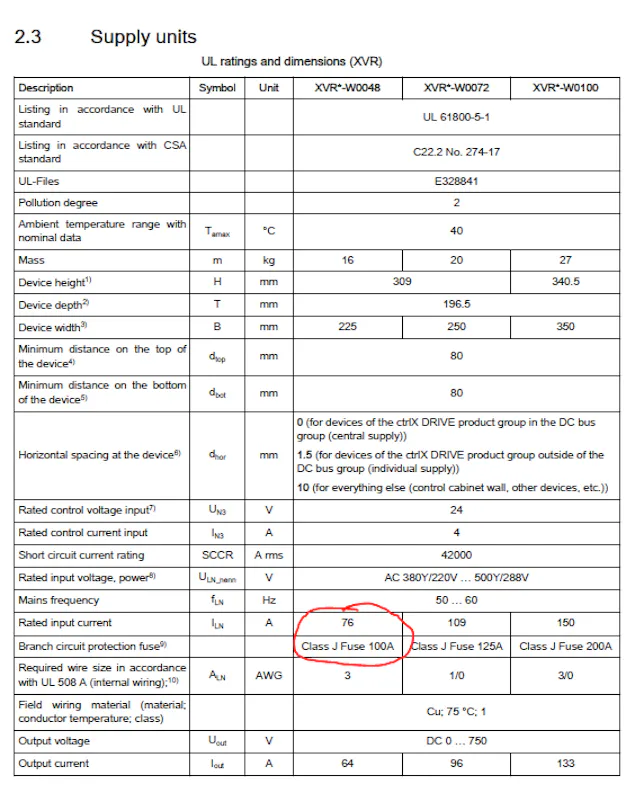

Wat is the “Rated Input Current” and the “Branch circuit protection fuse” ( marked in red in the table Supply Units )
Used material :
XLI1-1R-W0019N-A-FA1100N-NNNN-NN and XVR2-W0019ARN-01AETNNNNNN-S03RSN2NNNNNNN
Used material :
This is the current needed to get the continuous power out of the device. And the fuse is the recommended one according to that rated input current.
