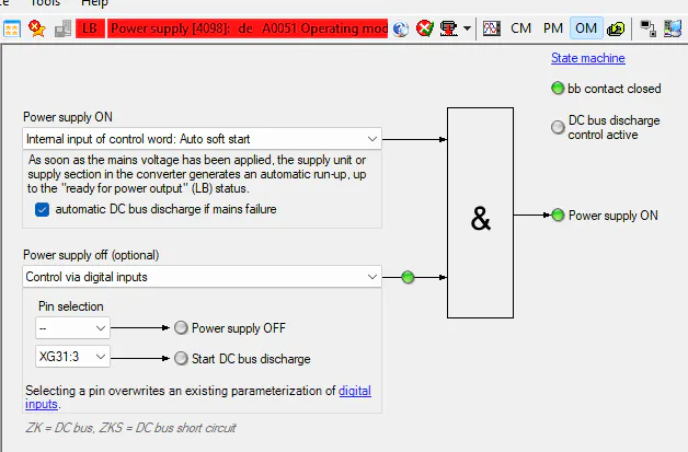

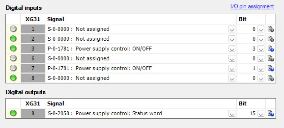

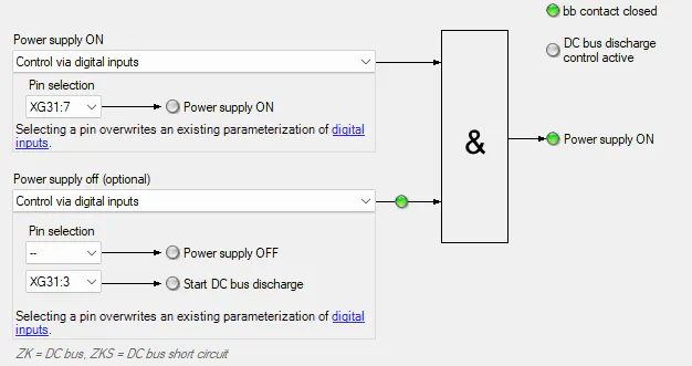

In my first configuration I selected the next options according with the manual. The problem was that we activated the digital input for power supply ON but the system don´t have any reaction, no pass to LB...
Then, we had to configure for the power supply ON the option "AutosoftStart", because via digital input XG31.7 didn´t works.
With this configuration, the power supply starts the power ON automatically and when I remove the XG31:3 signal, the system go to ZKS state. The diagnosis led is always flashing in red.

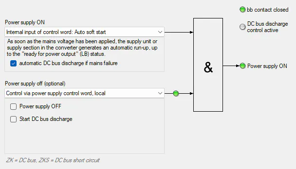

The problem is that after restart the XVR, the system go to CM mode and I need connect via software for pass to OM and the settings change on their own as follow:
