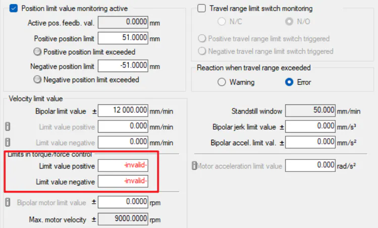

Besides, I have also problem when setting "motion limit values" in ctrlX Drive Engineering.
I could set the "limits in torque/force control" normally until some time point, but suddenly the parameters are shown as invalid and I cannot change them anymore. It gave me the pop-up saying "Error when accessing Sercos parameter P-0-0421.0.3", IDN does not exist. Restart does not help.
