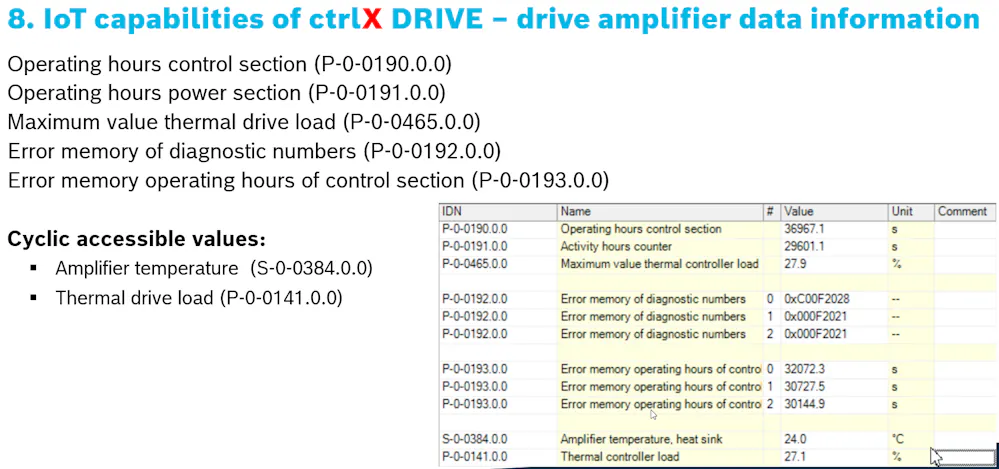

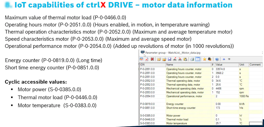

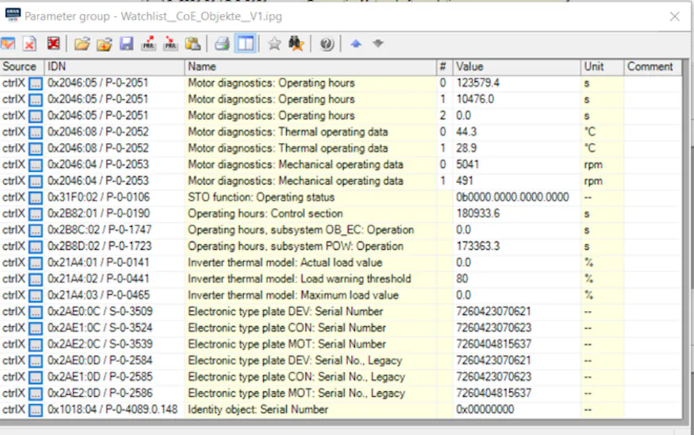

The already implemented functions and parameters for IIoT are the following:
Additionally eight signals selectable for the oscilloscope function (like within ctrlX DRIVE Engineering) might be used for trending (cyclically transmitting) of information in a 2 ms cycle or used in quasi scope mode with trigger, single shot, etc. and transfered over IIoT.
