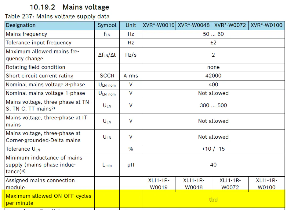

What are the maximum on-off cycles for the XVR?
Best reply by StefDu
Hello Rechi,
the value is 0,5 --> Turn it on and off once every 2 minutes
This value will be added in the next version of the project planning manual.
