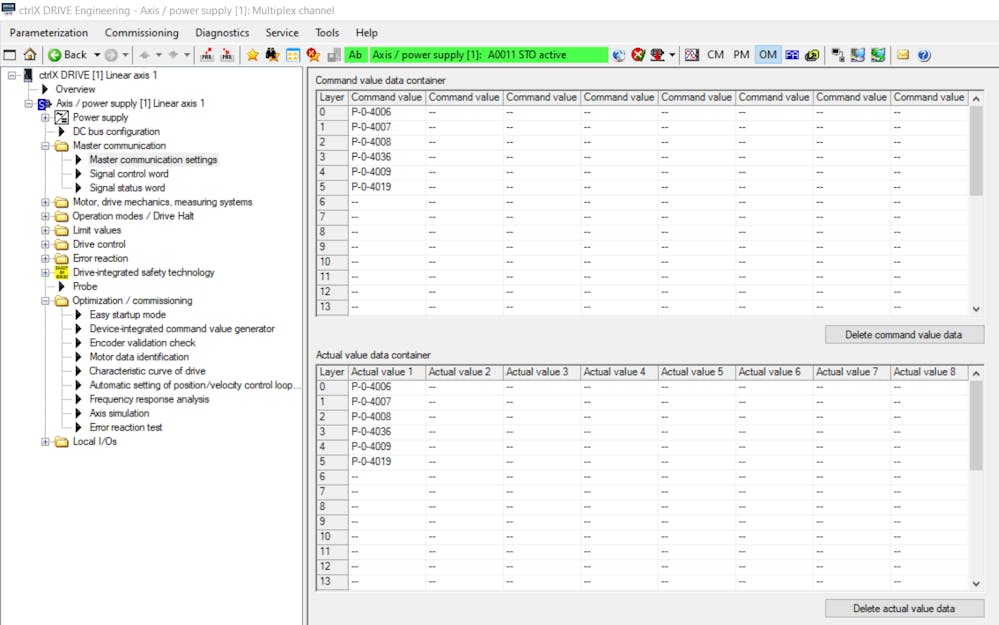

Multiplex Channel functionality
Is it possible to use the multiplex channel functionality in Ctrl-X as in Indraworks.
I would like to read and write PBM-parameters to the drive with the multiplex channel function.
Is this possible and if so, how and where can I configure the multiplex channel configuration?
Best reply by Drives_Uwe
Yes, this is possible. You enter the data in the parameters S-0-0370 or S-0-0371 and see them in the master communication settings. See:
