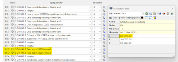

I'm trying to set up Fixed stop function on a XCS 23A with FWA 0402.02. Unfortunately, whenever the drive switches to OM the following diagnostic message is thrown:
C0242 Multiple configuration of a parameter -> S-0-0423
Looking at S-0-0423, it complains about S-0-0149 being duplicated at S-0-0027.

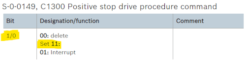

I expect this to be possible, since it takes two bits to set the function, according to the documentation.

Hello
in the signal control word commands can be executed with only one bit.
please erase bit 13 of the signal control word and start the command with bit 12
