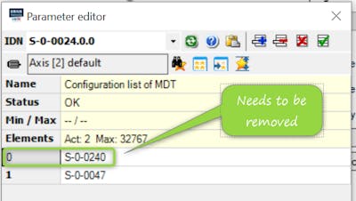

When configuring the XMD drives digtal inputs, setting an digital input to parameter DC Power Bus Control S-0-0240 and attempting to move to operating mode leads to this error: "C0242 Multiple configuration of a parameter ->S-0-0423". I believe this is because the DC Power Bus Control is also set cyclicaly by the ethercat master, however I cannot work out how to deactive this. How can I resolve this error?

The entry S-0-0240 in S-0-0024 needs to be removed in the XMD drives using the configuration possibilities for cyclic parameters within the EtherCAT control.
