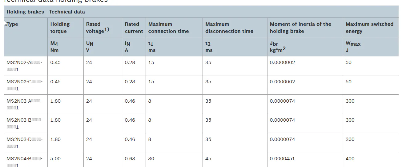

In the doc, i am not able to find the M1 which is dyanmic braking torque, has something changed? https://docs.automation.boschrexroth.com/doc/1708127638/holding-brake/latest/en/
I would like to make some checks for dynamic sizing for the application? could you please help me? how i can get the M1 values?
i would like to know what is the maximum brake torque during dynamic braking with tolerance?

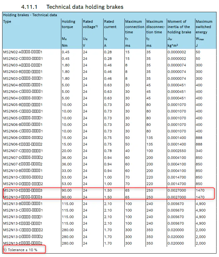

Question 2:
If i would like to have the maximum holding torque of the motor brakes stationary then can i consider +10% tolerance on the data for the highlighted in the below image for calculation?
Best reply by Drives_Uwe
For your question 2: The assumption with tolerance +- 10% is correct.
For your question 1: The M1 torque seems to no longer be shown in our manuals. We will check about.
