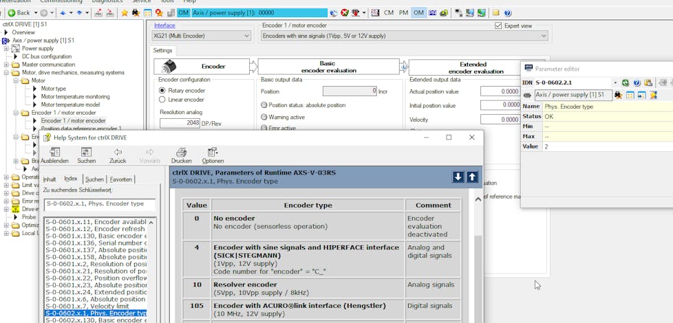

We find problems switching from CM to PM. We had problems, switched over to simulation mode but it still didn't work.Â
Â

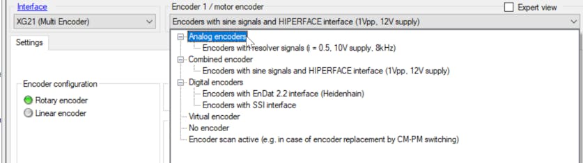

C1111 Incorrect encoder 1 parameterization (mechanics)
C0120 Coupled command C11 error ->S-0-0021
C1108 Encoder Basic: Error during encoder initialization XG21.x.y
Â
We checked all settings. Cable is RKG0074 for the correct pinout.
We did a Firmware udate from AXS-V-0306 to AXS-V-0308. Now the system works in simulation mode ! So in this firmware there are additions in this case. But the test with real equipment is still failing.Â
Does ctrlX AXS-V-0308 works with "C0" 1Vpp encoders of the MAD motor ?
