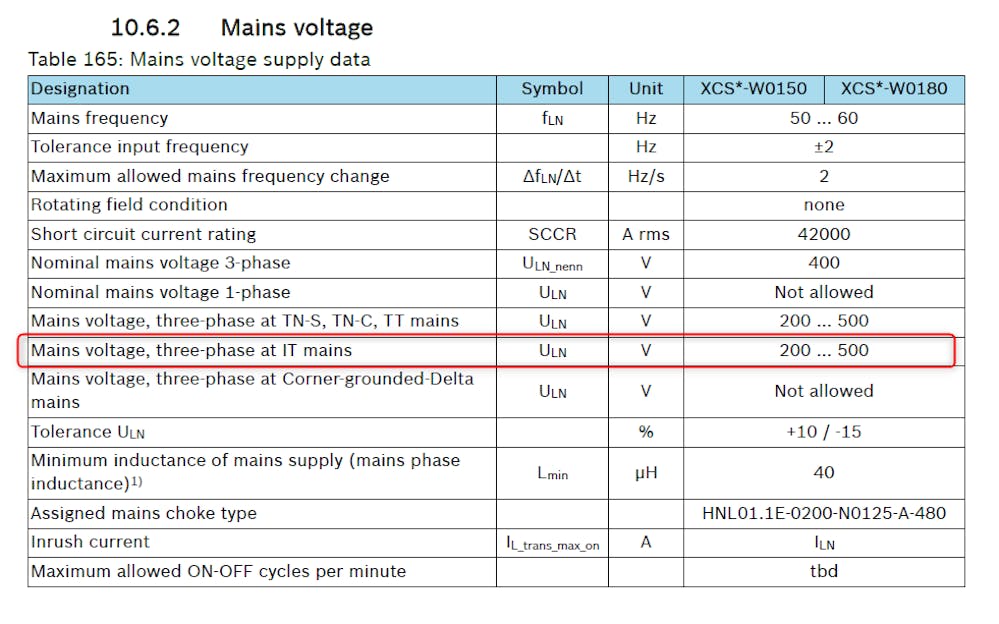

Reading the project planning, in the Mains voltage table of an XCS in seems that the drive can be connected directly to IT mains.

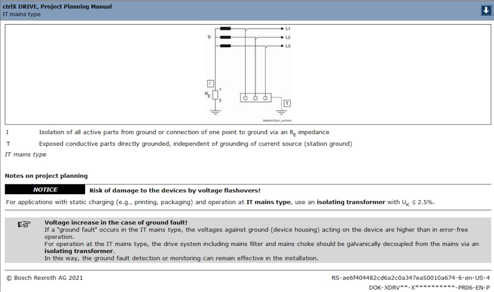

So, with IT mains, is an isolating transformer mandatory or not?
Best reply by Drives_Uwe
It is not mandatory but a high recommendation from our side, see:
