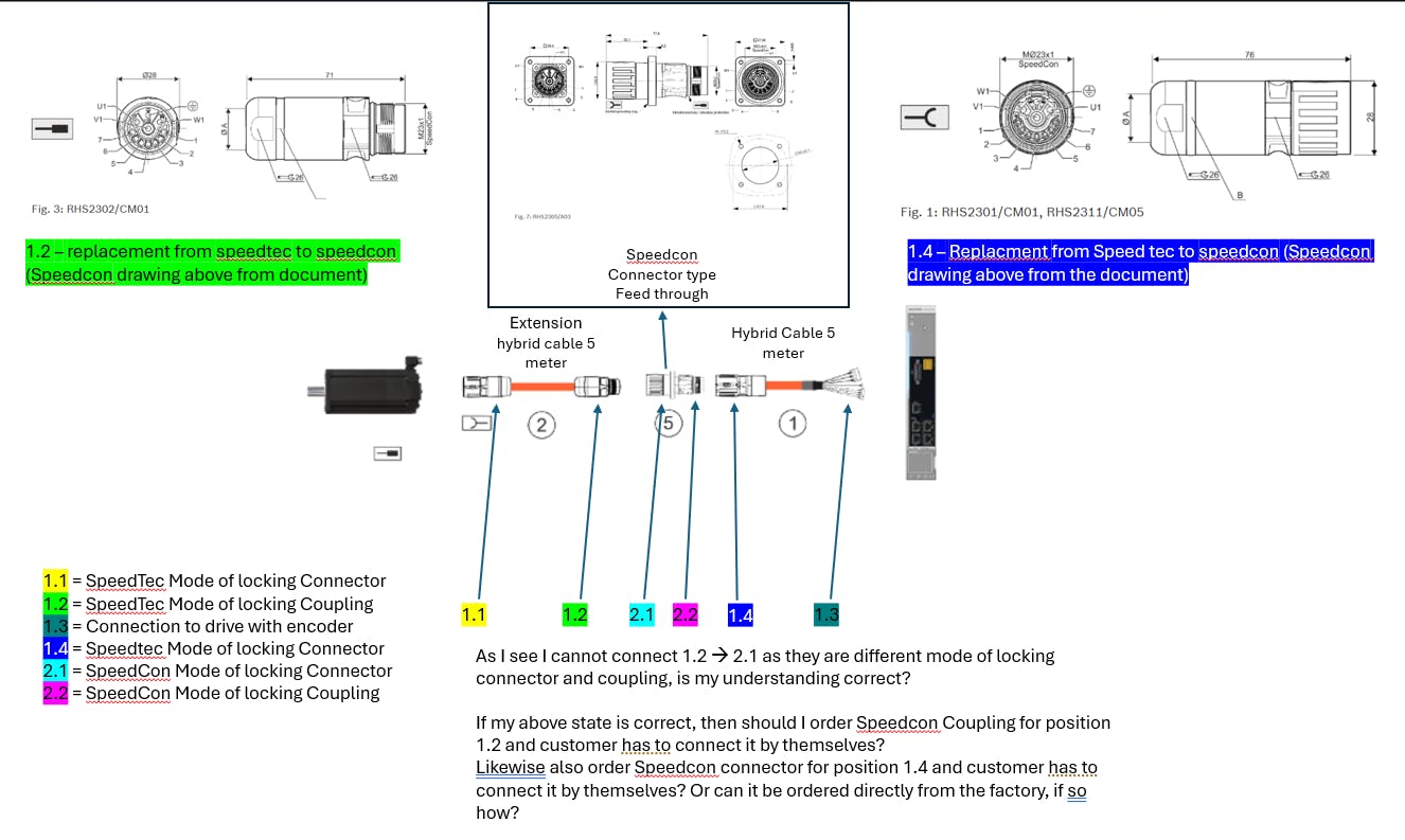

I want to make a configurations as below for connecting the Motor to the drive with the panel feed-through, please refer to the image below, could you please help me with the part numbers for the connectors and cables?
Please find my current configuration but i want panel feed-through connector inbetween as per the screenshot below.

so if i understand correctly, the below mentioned two cables come with Speedcon. Could you please guide me to a document which will help me with these connector details?
  • Hybrid cable extension โ€“ R914507359 โ€“ RHB2-521DCB-NN-005,0 โ€“ M23 โ€“ 5 meter โ€“ D = 1.5 mm2, C = 4x L + 2x 0.75 mmยฒ + 4x AWG 24 - DS
  • Hybrid cable โ€“ R914508025 โ€“ RHB2-021DCB-NN-020,0 โ€“ M23 โ€“ 20 meter โ€“ D = 1.5 mm2 - C = 4x L + 2x 0.75 mmยฒ + 4x AWG 24 - DS

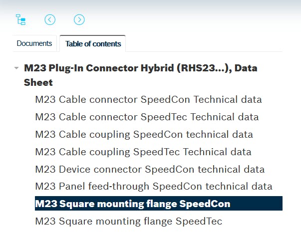

from the documentation i was a bit confused about the types of locking and I would also like to know the connector and coupling for cables, so could you please guide me to documents how I can make application for customers with such requests?
Yes i will suggest the customer to go with, the below cables and square mounting flange,

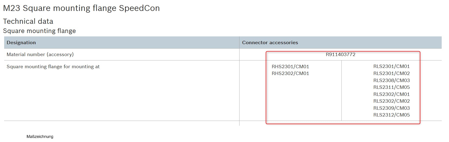

I new to this so could you please help me understand what is it ? from the below screenshot
What are those square mounting flange for mounting at?
