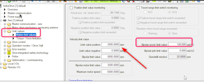

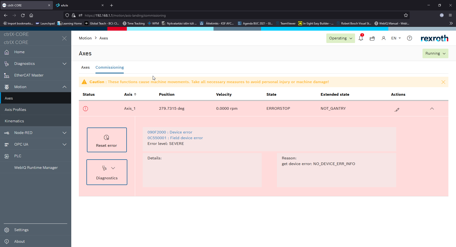

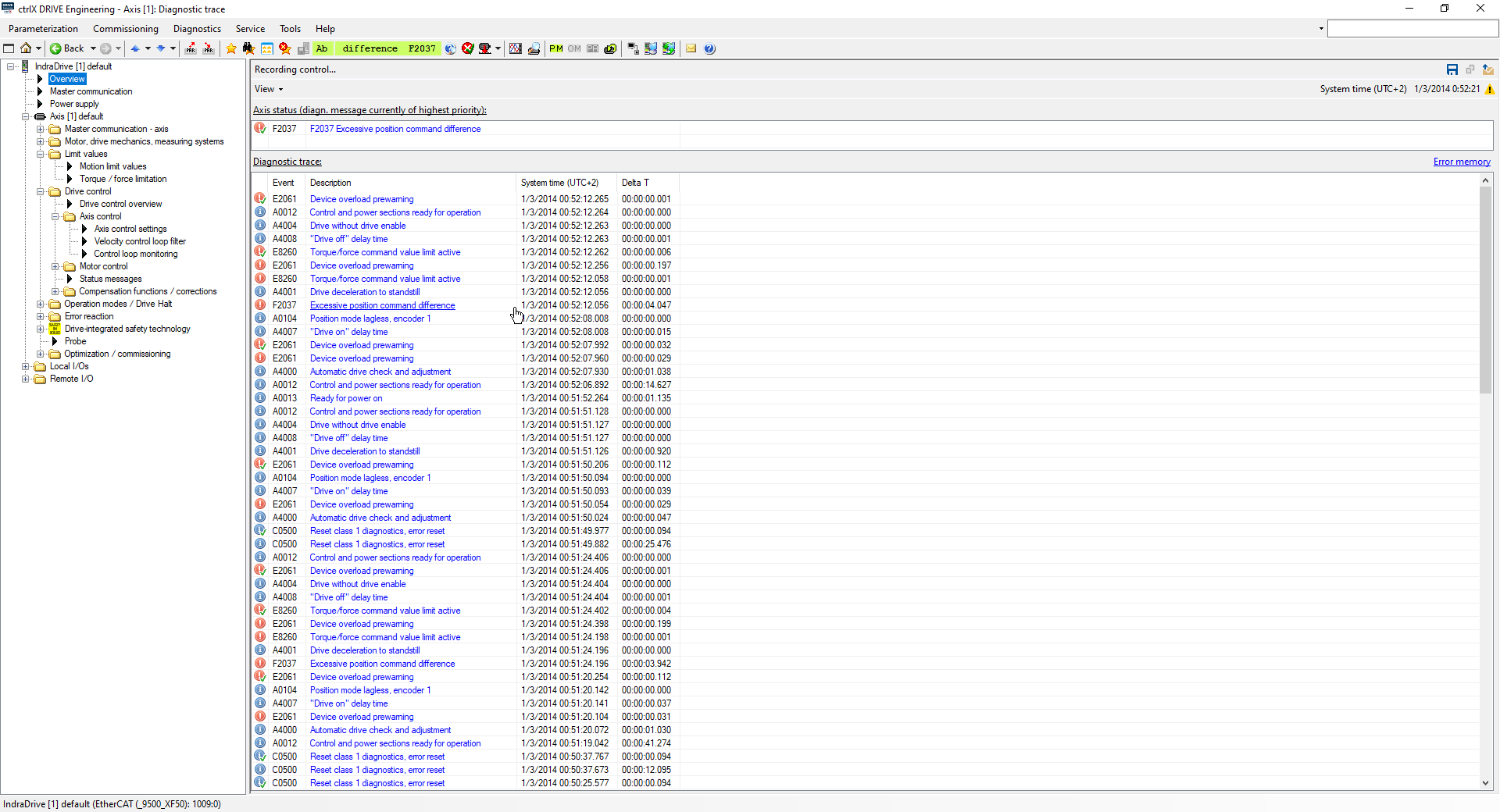

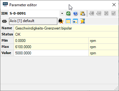

I'm using the CXA_MotionInterface. I can start the drive as needed, but after a certain speed 2000rpm to be exact, the drive stops with F2037 Excessive position command difference error. Under that speed everithing works fine. I tried to change the S-0-0091 parameter of the drive to a higher value as the help suggest but nothing works for me.

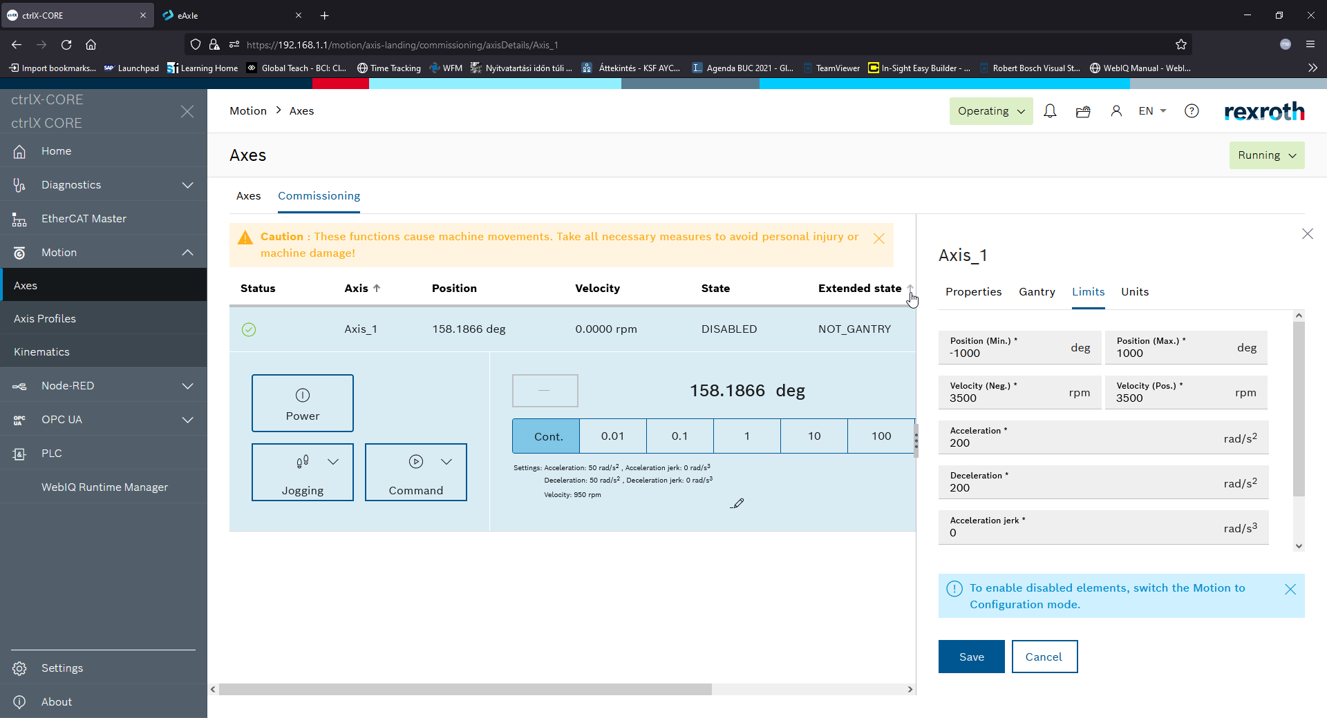

I checked all the limit values in drive engineering and also Motion app. Everywhere I have higher values than 2000 rpm. (see the attached photos).

Sorry for a really late response, but I could not do any test until now. Somehow I was look over the most obvious parameter. (red arrow)
Thanks for all of your help!
