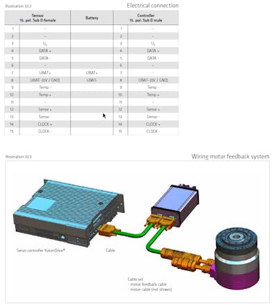

we have ot connect an ENDAT2.2 ENCODER with a battery box .THe encoder is part of an Harmonic frive  with MZE encoder interface.
0v of the battery box has to be connected to the drive. do you see any tricky point witch coulb be an issue?
