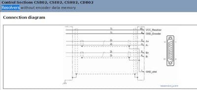

Can you help me with pin assignment of M17 connector  (Resolver encoder) on this servo engine. We ordered original cable but it will came in 3 weeks. For now i need selfmade cable for testing. It is impossible to find information cable pinout. I just found where to solder cables on D-sub connector.

Yes, sorry, you are right. there is a misprint in the E PLAN document:
+ UB on the motor side is not on pin 1 but on pin 2. --> So connect pin 15 on the drive side with pin 2 on  the motor side.
The rest of the plan is correct.
