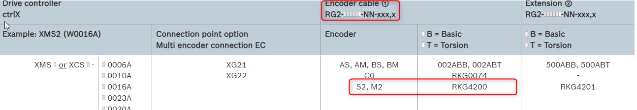

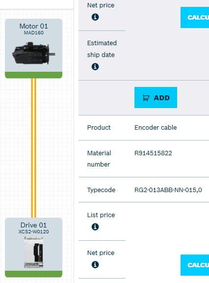

What is the right encoder cable between MAD160C-0100-SA-S2-... and XCS2-W0120ABN-01AETT0ECNN ?
Depending of where i looked for there is 2 possibilities : RKG4200 or RG2-013ABB...
with CTRLX configurator : RG2-013ABB-NN-
with online doc : RKG4200
