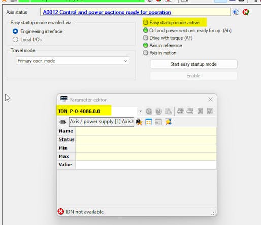

Easy Startup Mode active - parameter missing in ctrlX Drive
just would like to get confirmed that parameter P-0-4086 is not more available for ctrlX Drive?
Was it removed or just moved to different parameter? We used to use it with IndraDrive as monitoring whether there is not drive under manual control and can be control from master control (PLC).

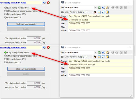

Best reply by StefDu
Hello
the indicator for "Easy Startup mode active" is now coupled to the command P-0-4085
regards,
Stefan
