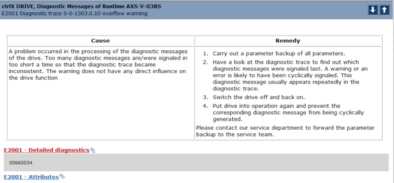

The drive keeps displaying this warning, not sure what is the reasons. Attached is a par file, please let me know if any ideas.

The diagnosis is telling the following and the following remedies are given:
Unfortunately in the diagnostic trace of the parameter file no clear root cause could be evaluated.
