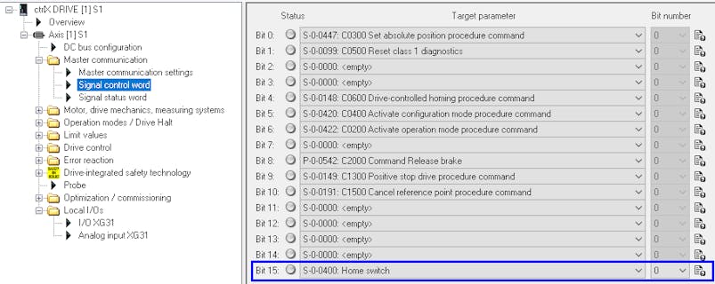

When switching over from indradrive to ctrlX drive we face the following behavior.ย
The home switch is configured over the Ethercat Bus. Signal Control word.

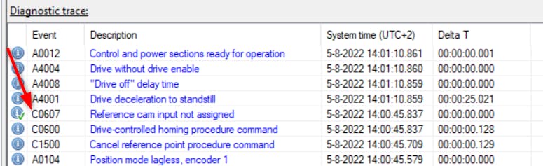

But During Homing the axis is arguing that the reference input is not assigned. But its set on bit 15 as you see above
We now wired it to the drive. But this should be possible. What could be the cause ?
Best reply by Drives_Uwe
This behavior has been accepted as a bug and will be resolved in the next release scheduled for end of March 2023. Up to that time the homing switch needs to be wired to the drive to a digital input.
