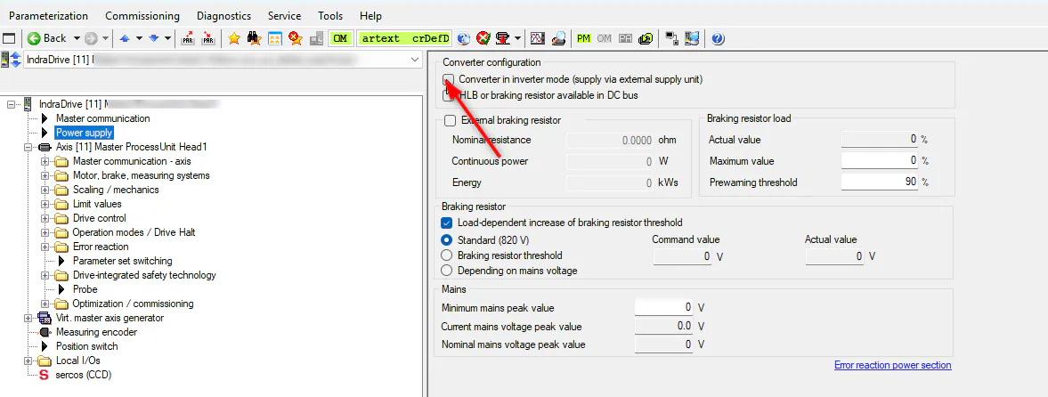

Now it comes down to the parameter settings. I can't really set in the drive firmware that I'm only using the second Drive as an inverter. I assume that the drive will simply go into 'ready' (bb/Ab) mode once the DC bus has reached the desired voltage level.
I see no showstopper and will proceed with this. However, a checkbox in the drive would have been desirable. As far as I know, this was provided for in the IndraDrive.

As before in Indradrive :

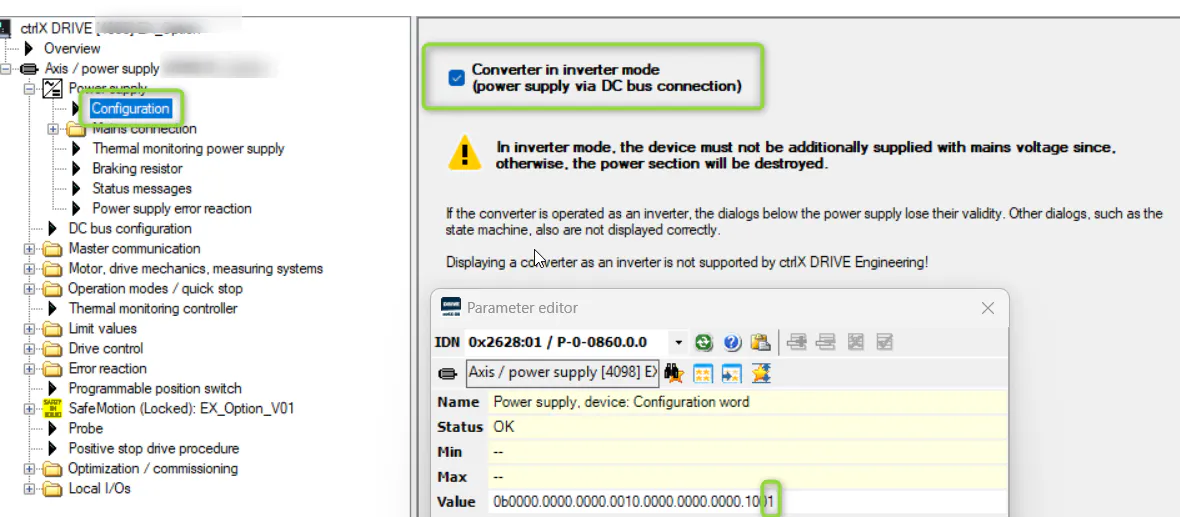

To your question: Can I connect the DC-bus of XCS to XCS, provided the power requirements are sufficient? --> Yes, this is possible.
You need to do the following settings in using ctrlX DRIVE Engineering 1.38 (!!! not latest 1.40 !!!):
In parameter 0x2628:01 or P-0-0860 Bit 0 must be set to "1"
!!! Mind to follow the warning given !!!
